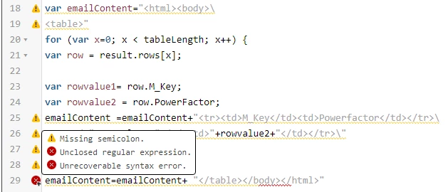

February 6, 2020
Try the following:
var emailContent="<html><body>\
<table>";
for (var x=0; x < tableLength; x++) {
var row = result.rows[x];
var rowvalue1= row.M_Key;
var rowvalue2 = row.PowerFactor;
emailContent =emailContent+"<tr><td>M_Key</td><td>Powerfactor</td></tr>\
<tr><td>"+rowvalue1+"</td><td>"+rowvalue2+"</td></tr>\"
emailContent=emailContent+ "</table></body></html>";
Things["EMS_MailThing"].SendMessageWithAttachment({
from: " xyz@gmail.com" /* STRING */,
to: " abcd@gmail.com" /* STRING */,
cc: undefined /* STRING */,
bcc: undefined /* STRING */,
subject:"Mail with table content" /* STRING */,
//content : emailContent,
body: emailContent /* HTML */
Note: I did not test the code, please correct syntax if necessary. The idea is to create HTML string in different parts, actually you are creating step by step the content of the email.

This doesn't work at the moment.
It gives the following error attached in the screenshot.
