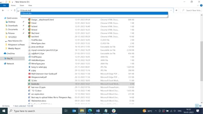

unable to add and sent attachment through mail
dear all , please help me
i hava attachment problem came here,

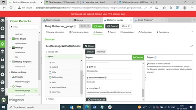

1.error is Unable to Invoke Service SendMessageWithAttachment on Mailserver_google : The filename, directory name, or volume label syntax is incorrect,

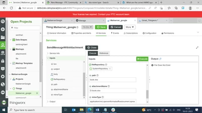

2.error is  File Does Not Exist
file is  D:\book.xlsx here location in there

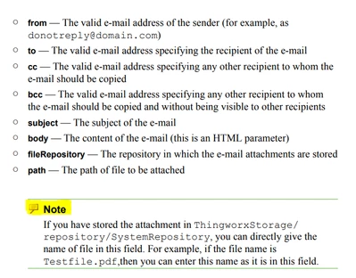

Keep the "book.xlsx" file at SystemRepository folder and try... Please refer attached document

thanks Mr. Sathishkumar, very useful to knowledge sharing. i resolve bugs .
 each file sent before System Repository upload after sent message.
