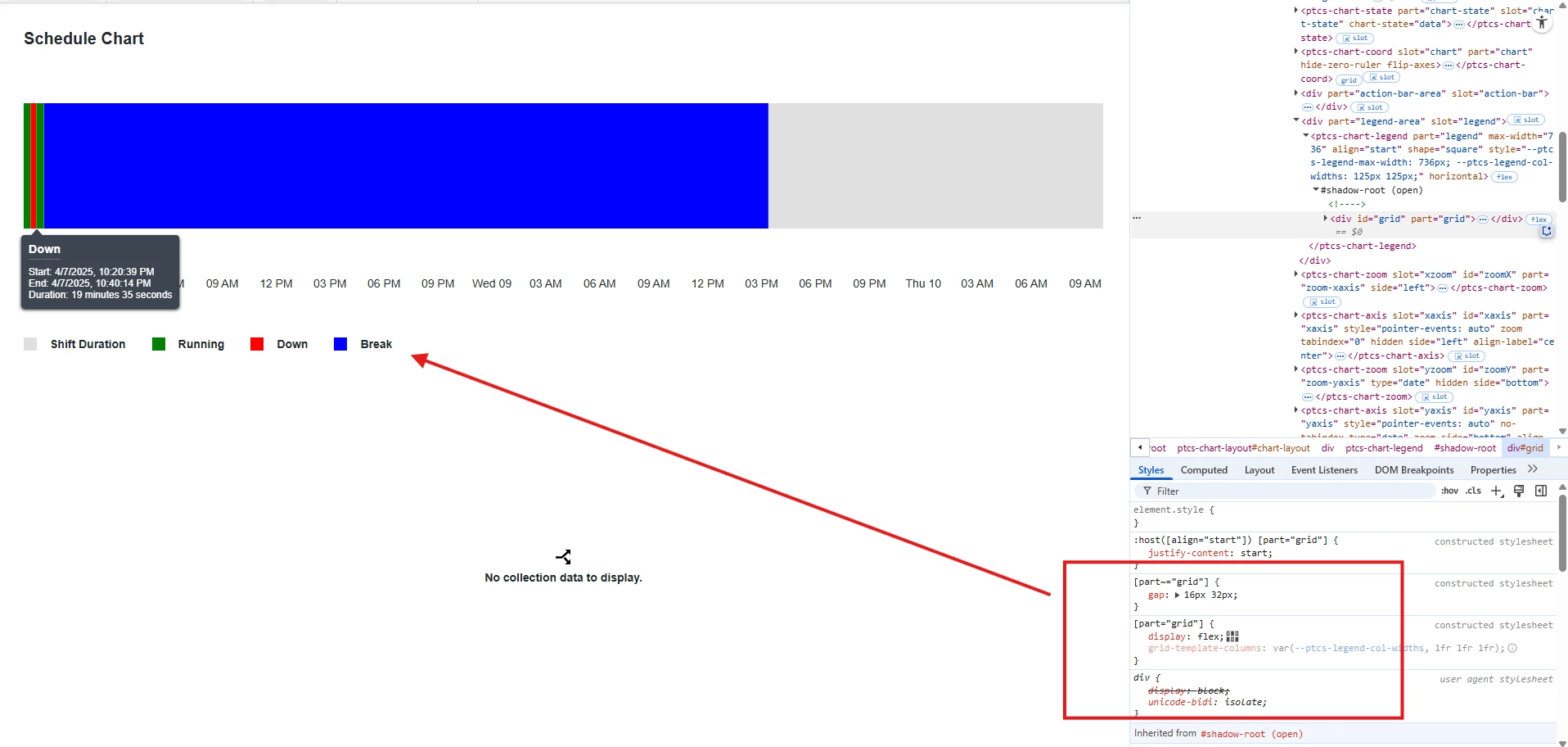

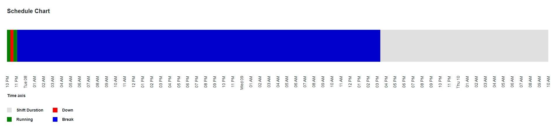

I'm currently working on a Schedule Chart widget and want to align the legend items in a single horizontal row (the legend is currently displayed as a grid layout).
When I inspected the widget at runtime and manually changed the display property of [part="grid"] from grid to flex, it worked as expected. However, when I tried applying this through custom CSS, none of my attempts had any effect on the widget.

When I applied the following CSS, the legend moved to the center, but it still displayed in a grid layout instead of a horizontal line.
