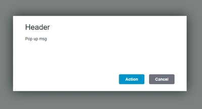

Hi @Janakiraman-P
The Style Theme does apply to the whole mashup, so if you have other buttons elsewhere in the Mashup, then they will also inherit this style.
There are a few options though:
- the Confirmation popup uses the Primary and Danger button type, so you can apply a different button type to the other buttons in the mashup and set a different style.
- You can also apply a specific style in Style Properties of the other button to override the Style Theme
Hope this helps
Kind regards
Christophe

Hi @Janakiraman-P
Could you possibly share a screenshot where you want to apply the CSS
Toolika Dixit
May 4, 2021 4:37 AM UTC
 Hi @tdixit ,
thanks.
I want to apply custom css on this confirmation box popup.
Could you please tell how to apply CSS to the buttons?
