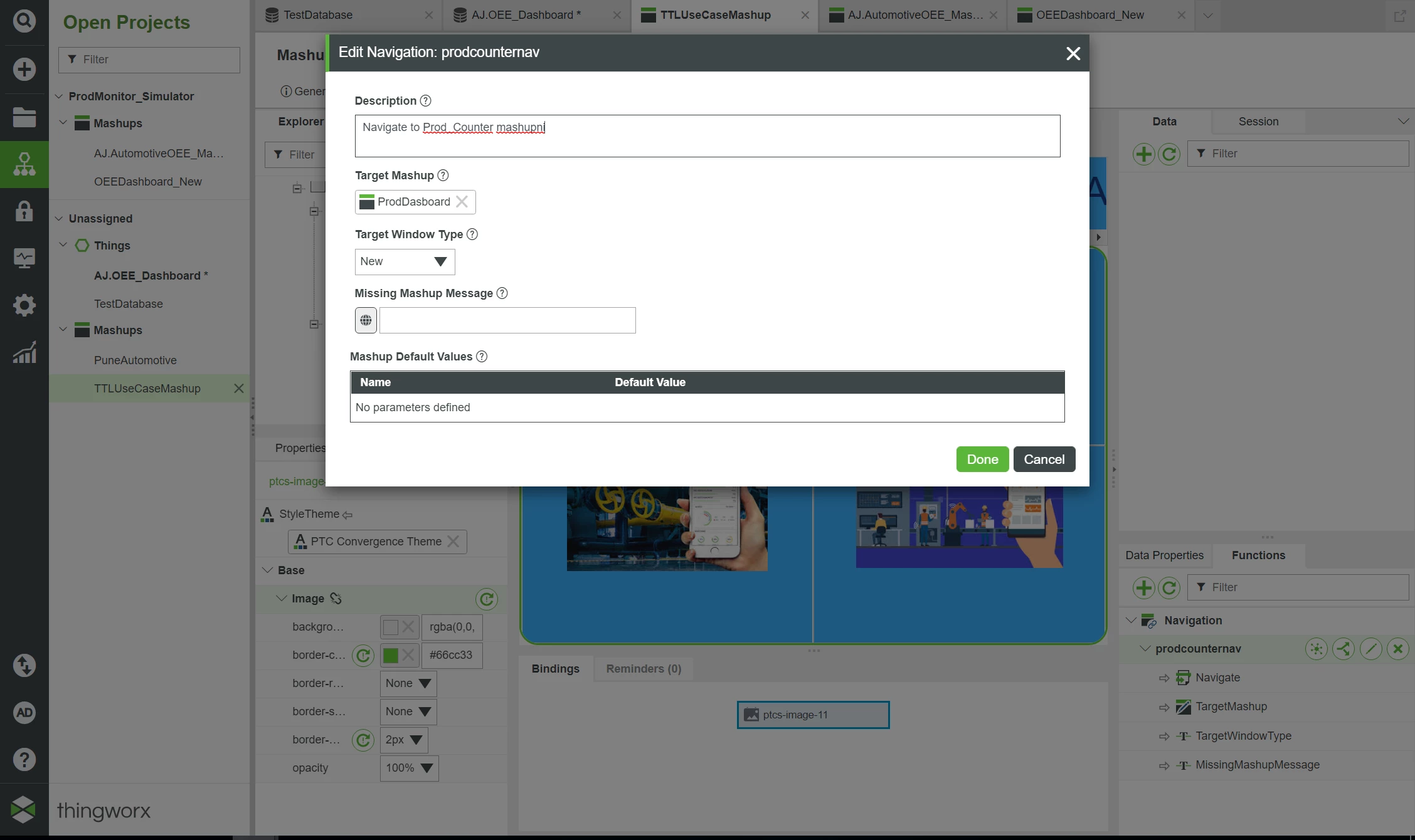

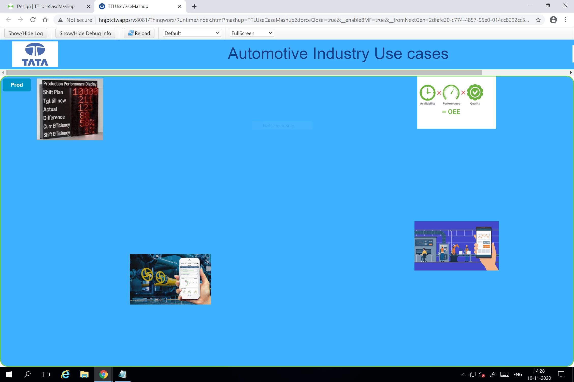

I have a mashup containing four images. I want to navigate to other mashups by clicking on these images.
I have configured navigate function and was successful in binding it to a button, but I want to achieve this on click of image.
I have attached images of my main mashup and function I created.
As Navigate function can only be configured for button, kindly suggest how to achieve navigation to another mashup by clicking  on image

Keeping button behind the image was my last option. I was looking for some out of box functionality from Thingworx.
But as I was not able to find any solution, I tried to achieve it (making button non-visible and placing it entirely on image), but on running mashup its not getting clicked.
Kindly suggest. Thanks
