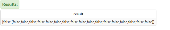

I have this issue:
FOR GREATER CONTROL, ​I wrote the MYFUCNTION in one service called STATE.
SERVICE:
  return [Status_RUN,Werror];
//binging
var result = MYFUNCTION(me.SystemStatus,me.WarningFlags);
SUBSCRIPTION:
I called the service:
var result = me.STATE();
then I bound propreties:
    //------------Binding propriety Status_RUN-------------------//
    me.Status_RUN = result[0];              //BOOLEAN
  //------------Binding proprieties WaringFlags-------------------//
      me.Hopper_1_Backup =    result[1][0];        //BOOLEAN
      me.Hopper_1_Empty =      result[1][4];        //BOOLEAN
      me.Hopper_1_full =          result[1][10];      //BOOLEAN
      me.Sd_card_full =            result[1][16];      //BOOLEAN
Doesn't work, the values of the proprieties doesn't chage!!!
CAN YOU HELP ME???
