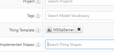

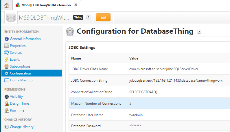

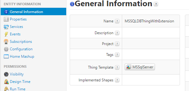

Thanks for clarifying . I could see the same behaviour until i imported the MSSQLConnector_Extension Relation Databases connectors
It appears the JDBC driver already included is not accessible like that, after importing the extension I created a Thing of ThingTemplate MSSqlServer (FYI this added sqljdbc jar in \\webapps\Thingworx\WEB-INF\extensions)
And following configuration :
Hope this'd help.
