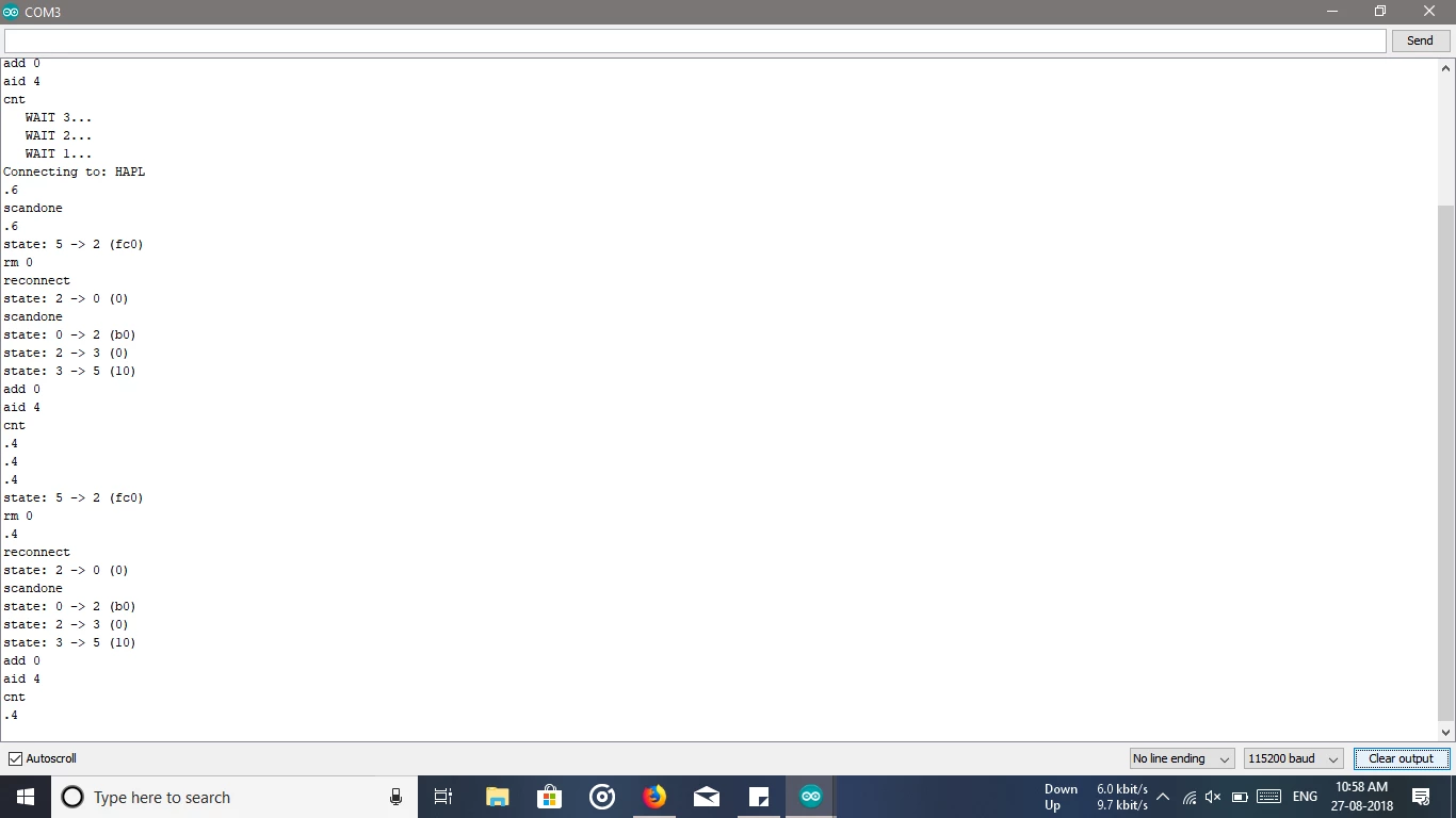

unable to connect ESP 8266 (wemos d1 mini) with thingworx
i am using Wemos d1 mini an ESP8255 based board. i followed the tutorial name "Connect an Arduino Developer Board" and used the code given in it. By using Arduino IDE i compiled and upload the code in it with nesassary changes in code like wifi ssid name, password, server address and app key. but it is still not connecting.
here is the code

    Aug 24, 2018 12:51 PM UTC
    I am not able browse to the ThingWorx server listed in your code. The Developer Portal servers are automatically shut down after a few hours of inactivity and must be restarted by logging in to your account.
    Did your code output any messages in the serial console?
    Aug 27, 2018 5:30 AM UTC
    i tried it when my server is running, as shown in course"Connect an Arduino Developer Board" the output expected on console doesn't not match with the output that i get.also the new thing should be shown in platform name "ESP8266Board-XXX where XXXX replaced by the last 4 digits of boards WiFi MAC address. i attached the screenshot of console output.

    Hello ajaygore,
    I'm running into the same issue, and I'm going through the same tutorial with my Wemos D1 mini chip.
    I had the same results in the screenshot that you're getting. After some digging, I found that the code isn't passing the wifi password when it tries to connect.
    So you'll edit the WiFi.begin(WiFiSSID); line:
    From this:
    To this:
    WiFi.begin(WiFiSSID, WiFiPSK);
    In Aruduino IDE, when you use the WiFi.begin command, it's expecting the network name and password as inputs.
    So the typical call looks like this:
    WiFi.begin("SSID", "Password");
    I hope this helps!
