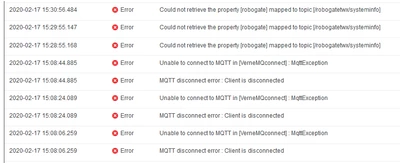

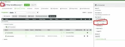

But the Problem is that the VerneMQconnect always show "Disconnected"
and "isConnected" never turn "True" it's always "False".
There is no firewall issue or somthing like that. I have tested the MQTT Broker in different ways ant it always worked without problems. Except in Thingworx, here it doesn't even manage to connect to the Broker. The Error Log schows:

This is a bug. I am assuming you are using v2.1.0 of the MQTT extension. When using v2.1.0 & ThingWorx 8.5 isConnected and lastConnection properties are not updated. Publishing and subscribing properties works fine. v2.1.0 also works fine on 8.4.
This has been fixed in MQTT Extension v2.1.1.

Franz931-VisitorAuthor
February 24, 2020
First of all I want to say thank´s for the answers
Unfortunately, i forgot to attach the Picture.

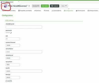

Which MQTT broker are you using?
If you are using RabbitMQ, you need to enable MQTT protocol (1883 port ) by executing below command:
rabbitmq-plugins enable rabbitmq_mqtt
And then create a new user that has privilege to do remote desktop, command such as:
rabbitmqctl add_user mqtt-test mqtt-test
rabbitmqctl set_permissions -p / mqtt-test
rabbitmqctl set_user_tags mqtt-test management
If you are using Mosquitto broker, that will be easier, just start Mosquitto.
You can test MQTT template as well (MQTT is one of three templates, rather than MQTTConnection), it has connection and subscriber together.
For RabbitMQ broker/thing with MQTT template, you need to set servername/userId/password/mappings; for Mosquitto broker/thing with MQTT template, you just need to set servername/mappings.
I attached a simple explanation about MQTT that was created by our colleague before, hope it helps.
