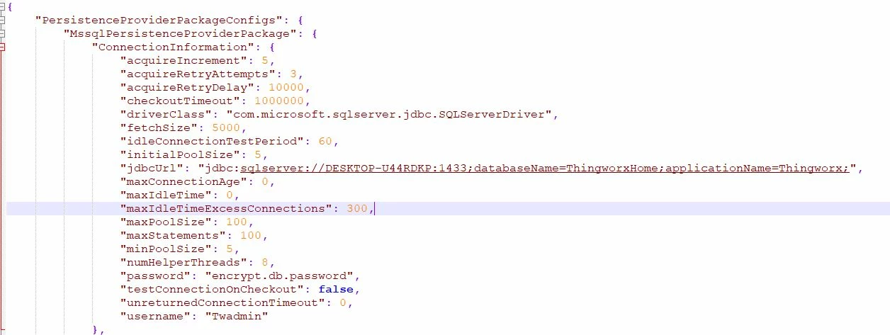

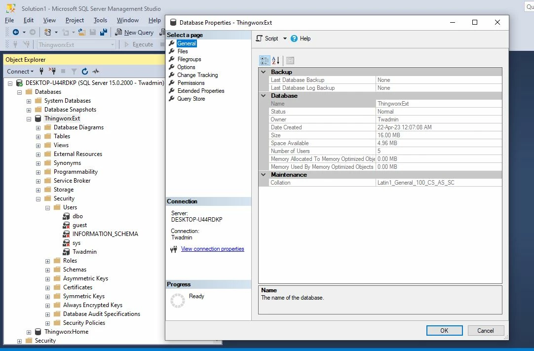

I have recently installed Thingworx 9.3.7 on MSSQL 2019 with DB name as ThingworxHome as a persistence provider.

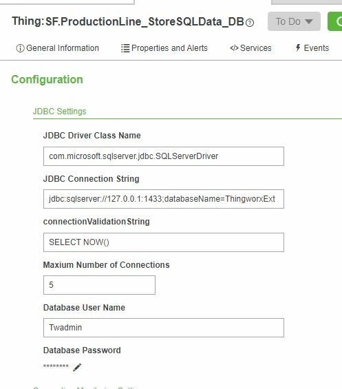

Also I created 1 DB thing on same as ThingworxExt to test sql queries from platform. I am not able to establish connection.
I am sharing details as below along with screenshots:
JDBC Driver Class Name : com.microsoft.sqlserver.jdbc.SQLServerDriver
JDBC Connection String : jdbc:sqlserver://127.0.0.1:1433;databaseName=ThingworxExt
connectionValidationString : SELECT NOW()
Database User Name : Twadmin
Password : 123xxx
Any suggestion to track and trace how I can confirm all my settings are correct or not.

Please confirm my understanding.  ThingWorx is running successfully, but you're unable to make a secondary connection to another SQL Server database running on the same SQL Server instance?
I noticed in the screenshot of your connection information, the connectionValidationString needs to be updated for SQL Server.  Change it to:
SELECT GETDATE()
Also make sure to update the database password field.

Apr 21, 2023 8:17 PM UTC
Hi Sharon,
Thanks for your quick reply. It seems I was passing wrong input to connectionValidationString  because of which it was not establishing connection. Now after updating same, it works.
