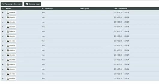

I am using ThingWorx 8.3.0 Version with MS SQL Database connection. After installing ThingWorx analytics, ThingWorx start to do not accept any Save requests. For Example i try to add a property a thing and hit save button. It shows me a diolog box which says "Active Edit ... user is currently using this entity". It doesnt matter that pressing Overwrite or Discard buttons. Also i cant create a new thing. When i look the Active Users section, my username seems to repeat so many times with same Last Connection timestamp.

I also forget to mention that ThingWorx Analytics also doesn't work. For example i tried to upload a JSON and CVS dataset it stuck in uploading state end it never finish. I re installed ThingWorx Analytics and i briefly saw ThingWorx-AnalyticsServer Thing which provide connection two platform. And then there was an error about cannot find ThingWorx-AnalyticsServer  Thing and suddenly i start to unable to verify connection between Thingworx any Analytics Server. After a rebooting the problem started about can't make any permement changes.
Some of Application Logs its follows:
[context: com.thingworx.webservices.context.HttpExecutionContext@734b88ac][message: Unable to Invoke Service CreateThing on EntityServices : Unable to create thing: PMITRTORAPP53-AnalyticsServer : [1,002] Data store integrity violation error: [Error occurred while accessing the model provider.]]
[message: [1,002] Data store integrity violation error: [Error occurred while accessing the model provider.]]
context: com.thingworx.webservices.context.HttpExecutionContext@64948564][message: Unable to Invoke Service CreateThing on EntityServices : Unable to create thing: PMITRTORAPP53-AnalyticsServer : [1,002] Data store integrity violation error: [Error occurred while accessing the model provider.]]
