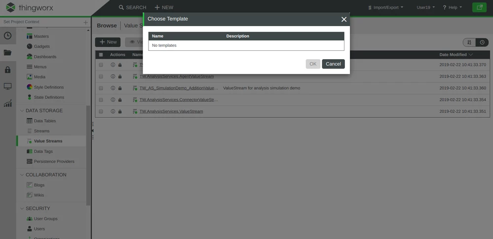

Unable to create value stream
As seen in the screenshot below, there are no templates to choose from when I try to create a new value stream. What could be the reason for this? I'm using ThingWorx 8.3.4-b993 trial version.
khongAnswer
March 23, 2019
Update: The User account that I'm using was added to the Administrator User Group. After that, I was able to see the template and create value stream

Try a full refresh of your browser CRTL+F5 and see if that resolves it, if not, then potentially that is a bug, I just tried on the released version of 8.4 though and the two templates show up fine.

Hi i faced a similiar issue.
This does not seem to work. Is there a permission that is supposed to be enabled to user to allow them to go into value stream?
My users can now see the valuestream object and create a value stream without a choice of templates. However when they try to access the value stream they created by clicking on it. It shows a loading screen forever.
22-Sapphire I
March 25, 2019
They probably need Visibility/Read Design/Runtime Service Execute to the ValueStream
They also will need Visibility to the Default Persistence Provider or Persistence Provider assigned to the ValueStream
