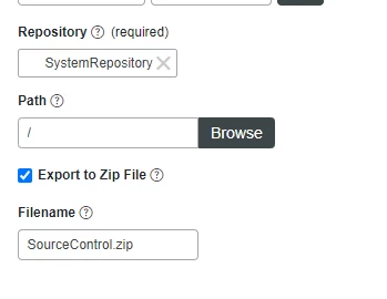

Yes Removing @ from Foldername works.
Is there any way to rename zip file generated by ExportSourceControlledEntitiesToZipFile method ?
Currently its taking Projectname by Default and Overwrites if exported on same location. I don't want it to overwrite but create new zip if export service is run again.
Manual Export Allows scope to name the zip so there should be way.

Don't think there are options in the unzip command, so I would recommend to anticipate the overwrite and place them in differently named folders from the start.
