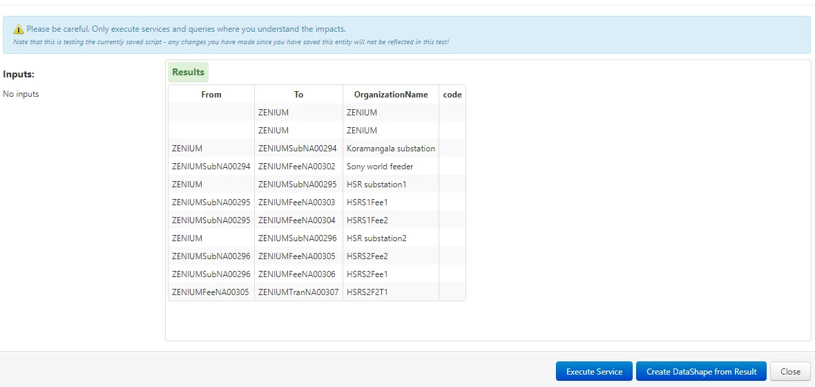

I'm using tree widget which will get input in a dynamic way.
I have used State as root element of tree, District, Substation and some other as children of the tree, Based on the user organization level of the user, I'm filtering the data and passing as input to the tree.  such as Bangalore is district I have Koramangala and HSR are 2 substations/divisions. It has other sub elements.
I have attached the output.
But expected output has to be like the root element and the below tree structure under the root.
Is there any possibilities to display tree structure including root element??
Thanks in advance

You aren't showing the actual table of information, but usually you would have a 'ID' with the Root name and it's 'ParentID' value would be null
or if you look at Thingworx networks it would be a To with a null From

@PaiChung , sorry for not sharing infotable earlier.
Since I Didn't get root element in the tree Earlier I have added one more row, same as root element but there is no use of doing so.
It's working fine with Collapsible D3 tree widget but not with tree and D3 tree widget.
I can't use Collapsable D3 tree widget because it will grow horizontally, which will not fit for my requirement.

I see you have the root listed twice, that might potentially cause an error.
