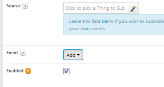

March 27, 2017
Extending on this .. we can also accomplish by adding a subcription on datatable and select event update or add , pass in the id parameter which is the primary key set of your datashape and script as like.. .
if(eventData.id)
Things['yourDataTable'].SecondServiceInvoke({Primary_Id:eventData.id});
So above subcription will always invoke whennever you add or update the datatable in this case you may set the event as ADD .
Also to note eventData.id will always return the newly generated primary key whatever you have set int or GUID

Basically, the first service starts a new transaction, and changes made by that transaction are not available to other threads (async services are new threads) until the transaction closes.
You are much better off switching to a subscription instead of an async service. The subscription will fire when the event happens (Add, Update, Delete, ect), which will be after the transaction closes.
