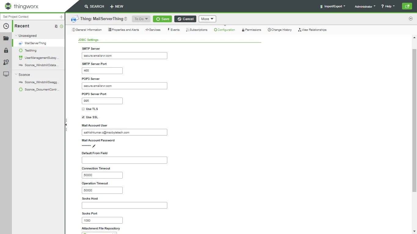

Hi All,
We are try to send email with Mailserver template. Facing below mentioned error.
Thingworx 8.4.2
MailExtension 3.6.0 / MailExtensions 3.5.1
Security Log:
Unable to send error email for logged incident: failed to connect, no password specified?
Error sending email due to [Could not connect to SMTP host: secure.emailsrvr.com, port: 465].The last server response was [null] with return code [0].The error originated on host [DESKTOP-EANFF4C].

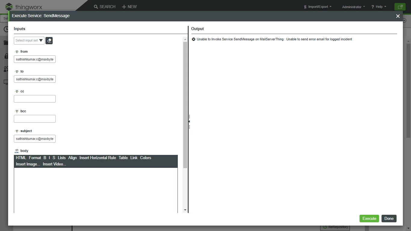

ApplicationLog:
[message: Unable to Invoke Service SendMessage on MailServerThing : Unable to send error email for logged incident]

Hi @Sathishkumar_C
I came across these articles which might be helpful for you. Please take a look a these.
https://www.ptc.com/en/support/article?n=CS253881
https://www.ptc.com/en/support/article?n=CS200624
Vibhuti
October 9, 2019
Thanks for the quick reply.
I referred both the documents but i am not able to send email from "SendMessage" service.
Thanks.
October 9, 2019
@Sathishkumar_C
Maybe the firewall is blocking or permissions issues.
Please refer this article https://www.ptc.com/en/support/article?n=CS236135
Vibhuti
