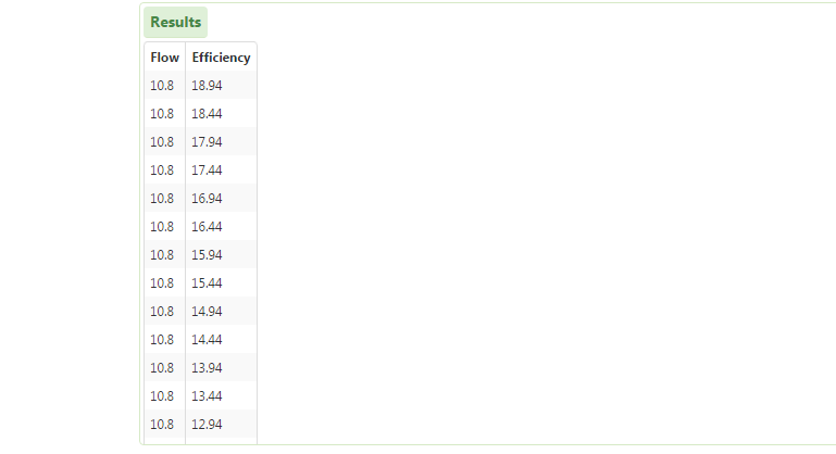

Dear Team,
How to get straight line parallel to Y axis on line chart?
My data points. Flow as X axis  , Efficiency as Y axis .

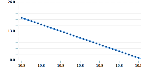

My chart is showing
Here x axis has same value i.e. 10.8 against y axis
But instead of x axis starting from 0.0  it is starting 10.8 .

    This label chart in which I am using line chart
    August 7, 2017
    I don't think it will render as you expect with label chart...
    Did you tried XY Chart?

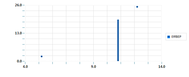

    bgupta-210-MarbleAuthor
    August 7, 2017
    In xy chart it is showing as require. But I need to show in line chart.

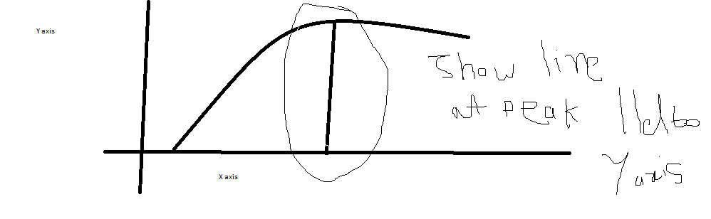

    August 7, 2017
    Thanks Carles,
    My requirement is as shown in below figure. I am showing line chart . On curve peak point need to draw line to x axis which is parallel to Y axis. such thing newd to show in line chart
    August 7, 2017
    Can you add up fake data points to increase X Axis ( minimum =0 and maximum= 20 for instance ) ?
    August 7, 2017
    You can set it on a separate series and also set it ( the fake ones ) to Marker only.

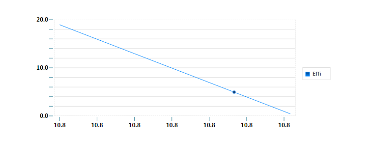

    Thanks Carles,
    In XY chart it is showing properly  as shown below,
    But when I am implementing in line chart and selecting as marker it is showing as below.Here problem with x axis.
    August 7, 2017
    Why X axis is not showing as per expectationsin marker( in label chart).

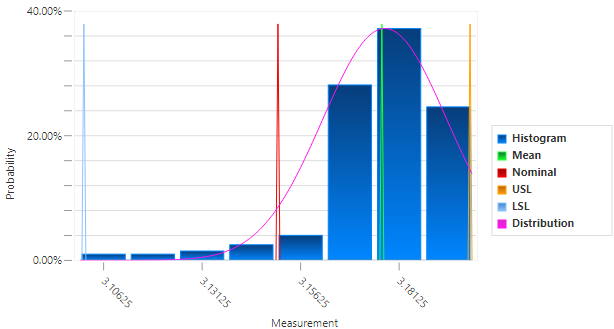

    this is exactly the same issue I'm facing. in order to create the vertical line, I have to create a "large set of " fake data and insert the real data point in the middle. But at the end, it will show up as a narrow triangle.
    so far, this is the workaround I'm using. Mean/Nominal/USL/LSL in this chart should be a vertical line.
    I'm considering to create a widget to support this when I have bandwidth.
