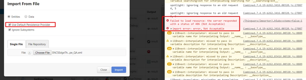

Unable to import a ThingShape file right after it is exported
The error is 406 Not Acceptable.

I have tried to import the attached ThingShape and it is importing without error (Important: enable Use Default Persistence Provider) in Thingworx 8.3.4 and 8.4.4 (H2).
But if Use Default Persistence Provider is not enabled, I get also "Not acceptable" error.
Also, check if you have connectivity to your database by connecting with twadmin.

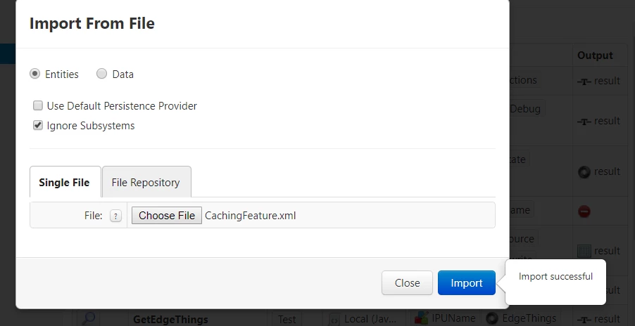

htran-2115-MoonstoneAuthor
September 9, 2019
Hi @raluca_edu
Yes, i also tried to enable "Use Default Persistence Provider", unfortunately it did not work either.
Of course, the connection is good cause that's a working system and i am using an Administrator account, I could import others well, except the one here. The TW version here is 7.4.19-b262.
Other entities, also other ThingShapes are working fine. CachingFeature is also a ThingShape XML and it works fine.
The different point is the one here is being used by thousands of entities. I assume that the system requires a long time to recompile all dependents and a timeout occurred internally. It seems to be a bug.
