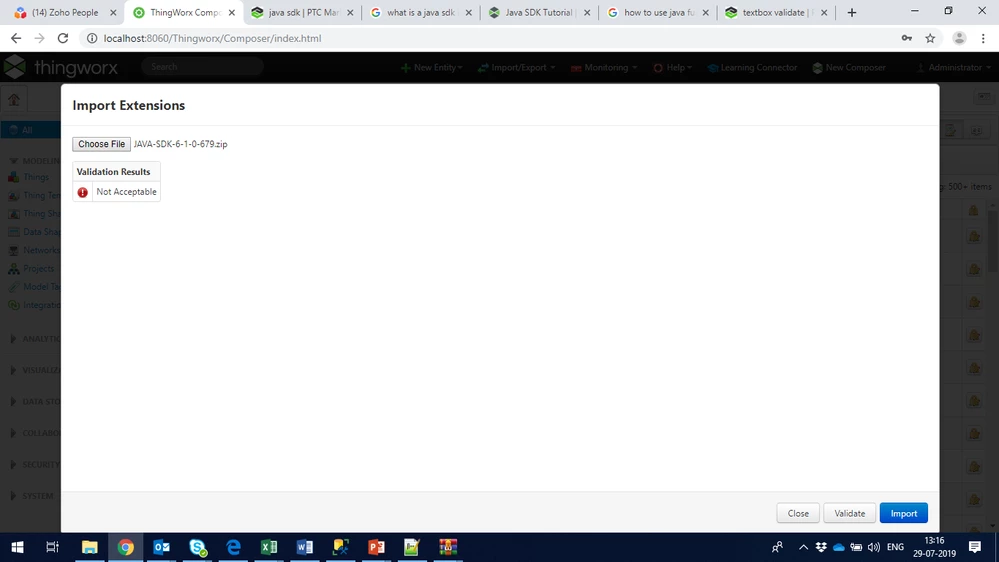

Unable to import Java SDK extension into Thingworx 8.2
  • I am not able to import the Java SDK extension in thingworx. Shows the following error.Screenshot (38).png

This is not a Thingworx importable extension .The ThingWorx Java Client SDK contains the required Java libraries(JARs) for writing a client in Java that is capable of communicating with the ThingWorx Server. It also contains a sample which you can import/use in eclipse and create a client to connect to ThingWorx .
