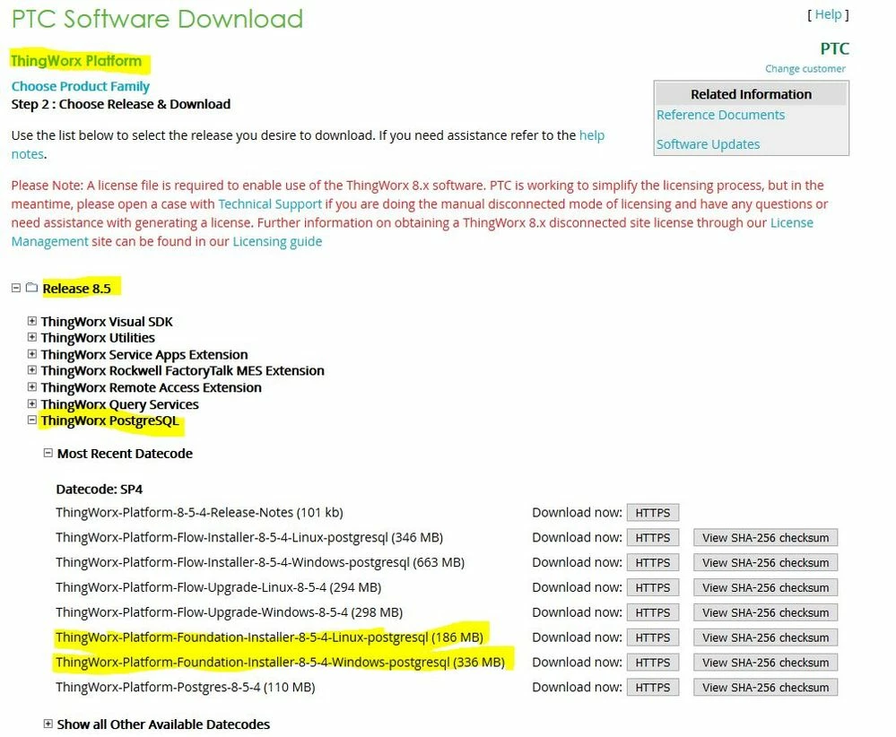

Hi @apdams.
Trial versions are designed this way to prevent abuse.  However, it's not necessary to remove a trial version in order to switch to a commercially licensed product.
Since the trial version has already been uninstalled, you can try running the foundation installer.  With a valid entitlement and PTC support login, you can download the product here:
Based on your earlier post, I assume you are interested in the PostgreSQL version.  Just download the  foundation installer for the required platform:  Linux or Windows.
Refer to this link for installation instructions.
If you still have issues, I recommend we open a case.  I would be happy to open it on your behalf.
