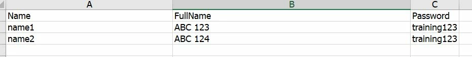

Here is service code and attaching sample CSV am trying to upload.

1. The mentioned error in the details is not giving more information. Can you provide more details from Script error log?

Thanks for your help, this issue is solved.Problem is with CSV file format.
