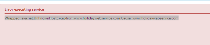

I'm getting this error.
Please help me fix it

    Your TW Server has DNS resolution? As I've tested your code on my TW Server and it works smoothly.

    Vemuri, the only time I get that error is if I give an invalid url, like holidaywebservices instead of holidaywebservice. Can you access that url link you're using in your service from the server that is hosting ThingWorx?

    No I'm unable to access the url link that is being used in my service from the server that is hosting ThingWorx.
    July 24, 2017
    That might be the problem then. Is that website/ link blocked or blacklisted? Please try using a different link, maybe something like this one.

    Even this link does not work in the server that we are using here.
    Thingworx is running on a server, Please help.
