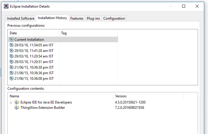

Unable to see Thingworx extension in eclipse
I've installed thingworx extension in eclipse but I'm unable to see in prespectives.

Mar 29, 2018 7:16 AM UTC

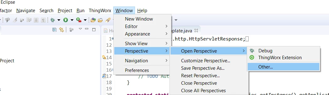

@SaiSameera Ensure in eclipse that the extension got installed successfully by checking installed software history. Go to Install New software ->  click What is already installed link and confirm ThingWorx Extension Builder is listed under Installed Software.
If extension is installed, then you should see ThingWorx Extension in Perspective. PFA for more details.
Hope it helps.
-Durgesh

Mar 29, 2018 7:26 AM UTC
 Hi dupatel,
The extension has installed successfully. But I'm unable to view in presepective. PFA for details
Mar 29, 2018 9:27 AM UTC
Thanks for your response. I'm able to see now in perspective. The reason is I've installed different eclipse version.
