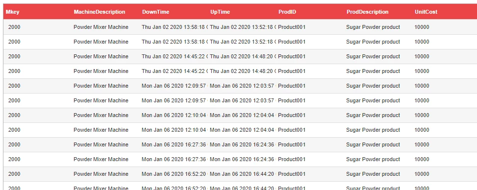

unable to set spaces in grid columns(Adv grid) in TWX 8.5.0
Hi ,
I am unable to see columns in Configure grid columns window ,  i have used external database and  getting data using query service  . output will be in infotable. already i have bound all data to grid and i can see data in grid . but i want some space in Grid columns you can see attached files.
