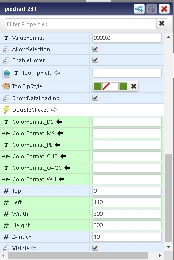

I tried  to bind colorformats dynamically on pie chart from an infotable service output . But colors are not applied on pie chart.Please find the attached screenshots.Let me know where It went wrong.Thanks in advance

As requested I have attached th xml file below.ON mashup load you can see a pie chart with colors left bottom.After clicking on right/left button beside pie chart,I am giving dynamic colors.Then it's not working.Thanks in advance

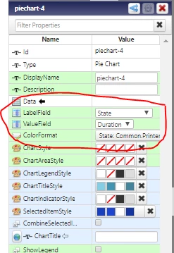

Is the answer that your info table should return something more like
PropertyName: SegmentName   (e.g. "MS" or "CUB")
PropertyValue :  300    (some integer value)

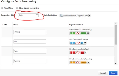

Then you need a state definition tied to the 'PropertyName' parameter to give you the colour you requiire.
We use the pie chart for a similar thing and our infotable looks like this
We then have a state definition like the below which is tied to the 'State' parameter:
so rather than your infotable having a column for each type ("MS", "CUB" etc.) you have an infotable with one column for the type parameter and return a number of rows .
The pie chart is then bound to All Data from infotable service and the pie chart settings are set accordingly. In our case:
