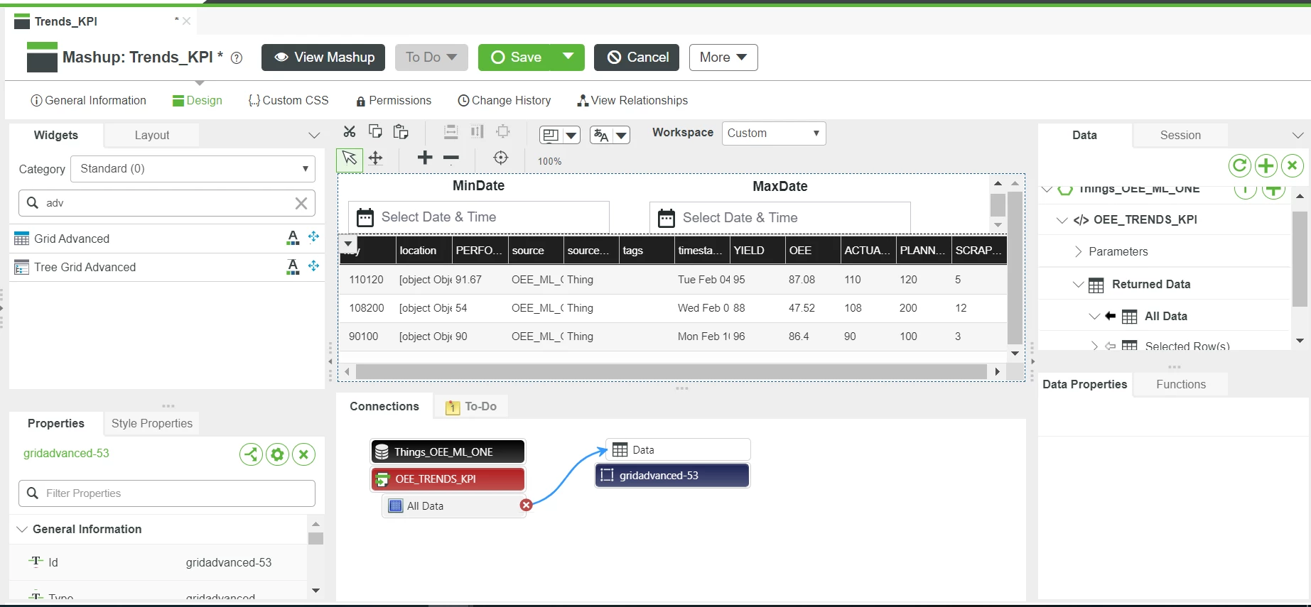

I am trying to show infotable result on chart and mapped the respective service to chart.

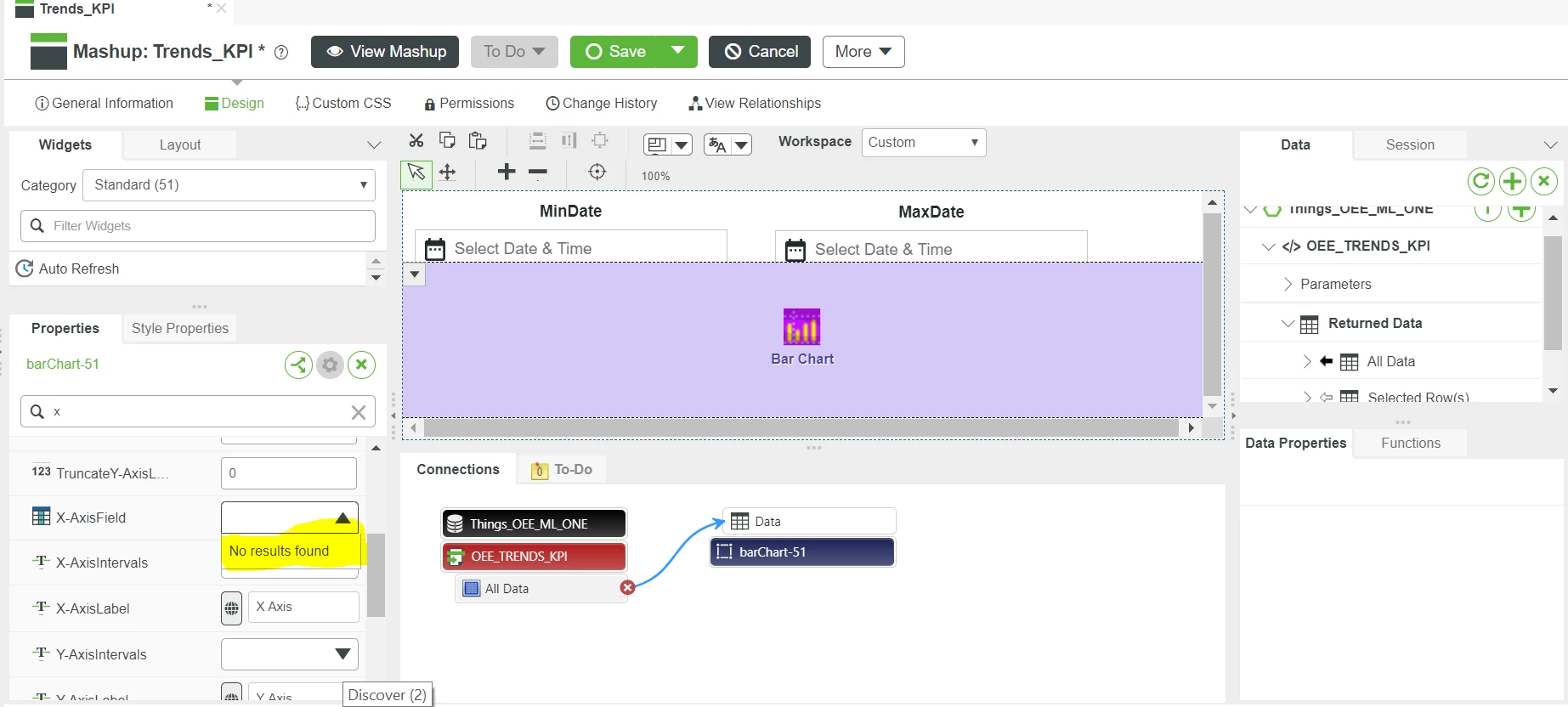

When I am trying to specify the X-Axis properties,it's showing "No result found".
But the data is loading on grid. I have attached the respective screenshots.
Is it something like it's a bug or I am missing something.

It worked after tagging particular Datashape for the output. After doing that the fields are getting loaded.

Set first X-AxisField, and afterwards X-axisinterval.

I am trying to set X-axis field. Drop down is related to X-axis field itself not interval.

Do you have any error in Application.log? Usually , you should see all fields in a drop-down list.
How many rows you have in the data you want to bind; do you have maybe specific types of data?
