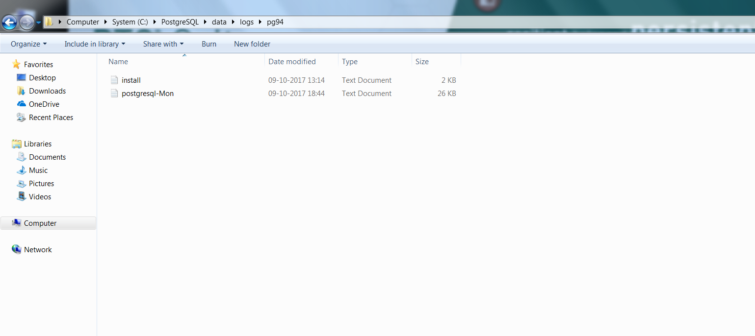

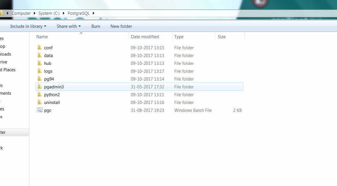

Oct 9, 2017 1:18 PM UTC
Which logs you are talking about as my Directory Structure looks like below:
