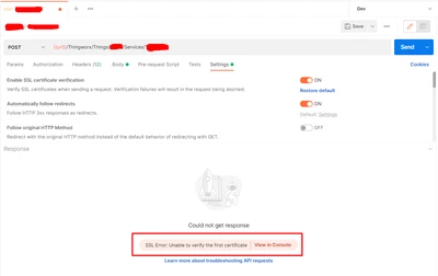

Not able run the Thingworx API without disabling the SSL in the Postman. Is there any way to run the Thingworx API's without disabling SSL in Postman.
is there some configuration issue ?

Obvious question, did you setup ThingWorx with a proper cert or are you using a self-signed cert?

not pretty sure on that, as of now thingowrx is running on an VM. Mostly it is an self-signed cert !!

It may be that it can't work with a self-signed certificate, I really haven't tried myself.

Are you using the SSL port as opposed to the non-SSL port?  Has trust been established between the cert running in ThingWorx and the client?  You can check the cert from your browser when pulling up ThingWorx.
This article may also help.
