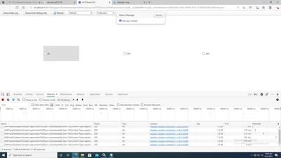

I'm unable to invoke collection CellWasClicked event in Thingworx 8.5.14, this feature working properly in earlier versions.
Widget is getting the clicked event instead cell, when we click out side of the widget or a gap between widget and cell then trigger happens. What if widget covers complete cell?

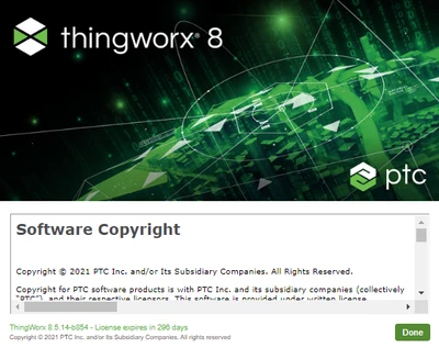

When we upgrade from 8.5.11 to 8.5.14, this collection features are not working.
Help Required!

@Janakiraman-P : I upgraded a system to 8.5.14 twx and CellWasClicked  was working fine on cell clicks only. Can you please create some sample entities at your end and check again? Please also share with us these entities and we will try to reproduce this at our end.

Thingworx Version

@Janakiraman-P : I tested with the entities you provided. The CellWasClicked event is working fine . I have also bound this to a status function message and its getting called on this event only along with the service 'Getpropertyvalues' when I click on the cell and not anywhere else. Can you please try in an incognito window ?
