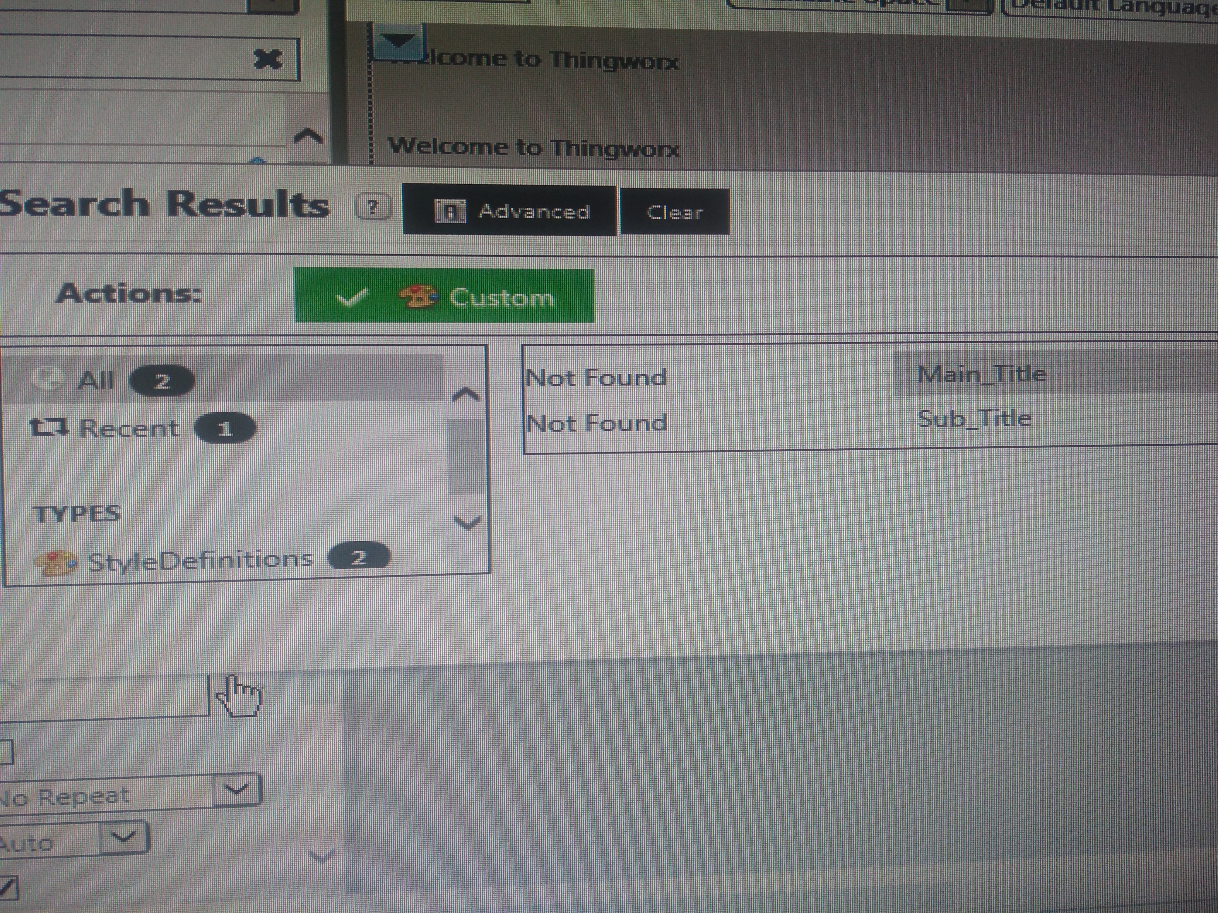

I checked it. I wish to clear you scenario in detail.
I created two style definitions for labels used in mashup and both these style definitions have complete access to view and edit for an user. Also the mashup where ty these are used can be edited by user.
But still these style definitions are not applied in mashup. There it says not found. Please find attached snapshot.
Please help me to this.
