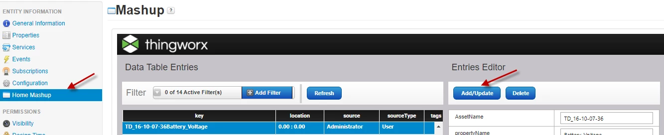

I was able to update existing DataTable entries through Home Mashup tab without using services in Thingworx 8.2.5.
Unable to do same in Thingworx 8.5 version. Where is the option to update and filter data table entries without using the services.
Could you help me on that?. Please refer the attached screenshot taken in Thingworx 8.2.5.

It 'should' be in the 'home mashup' section of the Entity
If not, you can try to find the mashup, it will be a system object in the mashup collection and then create your own mashup to bind in the DataTable name.
Parent mashup with an Entity picker and the child mashup being the DataTable mashup

Thank you for information. Working now
