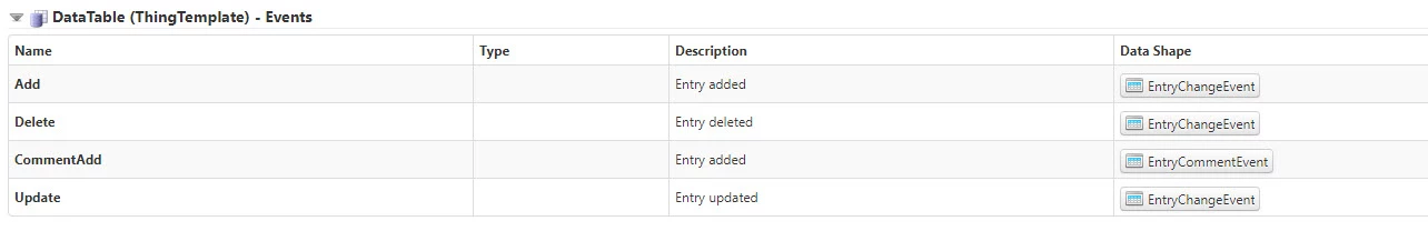

Hi @vranganathan is the datatable getting modified in runtime - i.e. varying number of columns? Or are you simply looking for data change event? If so, why not use Events inherited by DataTable fired on CRUD operation performed on the DataTable
May 4, 2018 10:35 AM UTC
Still with the Update event (for datatable entry) you won't get which column of the datatable was changed.
