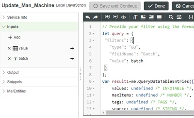

I am looking to update infotable rows, as a input to service only holds single row(selected from Grid). below is my code but doesn't work . please suggest how to update infotable row without primary key. after updating infotable i need to set it to Datatable. below are the snaps to get it clearly.
I have infotable with fields...MachineName & UserID (no primary key)
Datatable with Fields ...Batch(string as Pkey) & Members(infotable)
above full code here......

Hi @TonyZhang ,
Sorry, It's my bad. i have modified it but still unable to update infotable . but I have done workaround like..
1)get Members infotable stored in Datatable1.
2) add the Members infotable to Datatable2.
3)do update/delete operations on Datatable2.
4)get entries from Datatable2.
5)update at Datatable1.
and last purge the Datatable2 after update done. It worked for me.

UpdateQuery function will only return the row(s) that got updated not the entire infotable with updated records.
So you probably need to update every field one by one.
Please find below my code for reference:

Hi @TonyZhang ,
Thanks for your reply, Actually i am getting below error when i try your code.
TypeError: Cannot set property "FieldToUpdate" of null to "undefined" (Update_Man_Machine#90)
Support
July 15, 2021
Hi @VaibhavShinde ,
You should make adjustments to below line of code instead of copying my code as "FieldToUpdate" is a field I made it up.
members.Find(valueCollection).FieldToUpdate = value.FieldToUpdate;
Make adjustment depending on how the datashape you defined for your "Members" infotable.
e.g If your Members has following structure:
MachineName  UserID  FieldA  FieldB
Then change to below code:
members.Find(valueCollection).FieldA = value.FieldA;
members.Find(valueCollection).FieldB = value.FieldB;
