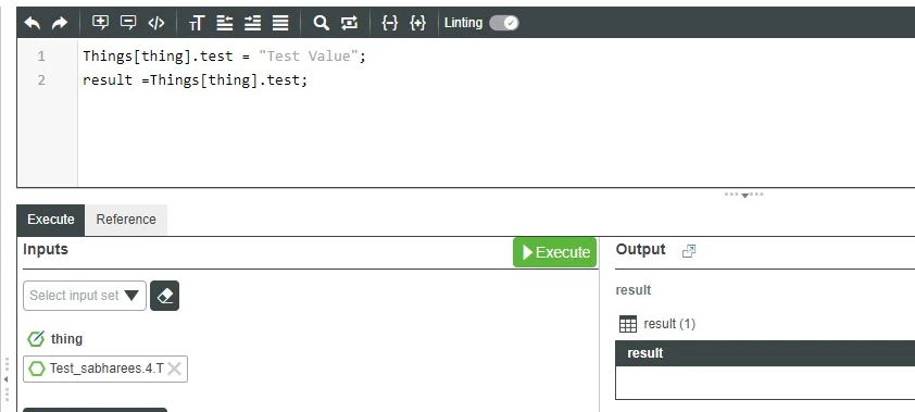

Hi, I have few properties (inherited from my Thing template) in my Thing.
I want to update my Thing's inherited property through service.
I tried :
Things[thing].test = "Test Value"; //tried to update value of my test property
result =Things[thing].test; // to check i printed it as result,
This method is not working for me ...

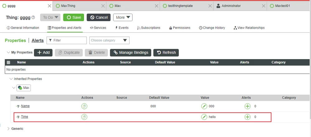

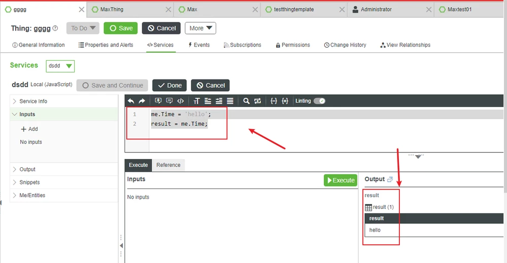

Hello @sabharees
I do the test for you in TWX 9.0.
me.Time = 'hello';
result = me.Time;
BR,
Max
