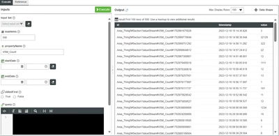

I am looking to update multiple properties by making use of the service UpdatePropertyValues but I don't seem to be getting it right.
I am using python to post my data and I get a 200 response back but the values are not actually updating when I use the service QueryNumberPropertyHistory.

NiKlaus12-AmethystAuthor
Dec 19, 2023 11:52 AM UTC
Hi @Yedukrishnan Yes the property is set to persist and logged.
I am able to see the property history after using the following API:
Payload: {"Item_count": 12}
Using the put method.
What other information would you need to assist? I am very new to thingworx so I am unsure at this point.
So when I QueryNumberHistory, I do see a history of values but when I use the :UpdatePropertyValues service, i do not see the values in the value stream.
Dec 19, 2023 1:33 PM UTC
Hi @Sathishkumar_C thank you for your response.
I have done the following:
curl --location 'http://localhost/Thingworx/Things/Area_Thing5/Services/UpdatePropertyValues?ts=1702937532012' \
--header 'Accept: application/json' \
--header 'Content-Type: application/json' \
--header 'AppKey: ####' \
--data '{
"values": {
"dataShape": {
"fieldDefinitions": {
"name": {
"name": "name",
"aspects": {
"isPrimaryKey": true
"description": "Property name",
"baseType": "STRING",
"ordinal": 0
"time": {
"name": "time",
"aspects": {},
"description": "time",
"baseType": "DATETIME",
"ordinal": 0
"value": {
"name": "value",
"aspects": {},
"description": "value",
"baseType": "VARIANT",
"ordinal": 0
"quality": {
"name": "quality",
"aspects": {},
"description": "quality",
"ordinal": 0
"rows": [
"name": "VSM_Count",
"time": "2023-12-19T12:12:12.012Z",
"value": "9999",
"quality": "GOOD"
My response is blank:
And still nothing in the value stream.
Hoping you can help further
