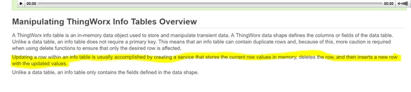

I just reviewed the InfoTable Manipulation at ptc university and the InfoTable Manipulation Overview (see pic below also) says that an update is usually accomplished by deleting the old row and adding a new one.  If this is true, I guess I have to first run the UpdateQuery.  The result infotable will contain the list of updated rows.  Then delete the rows in the original infotable that match the rows in result.  Then add the rows in result to the original infotable.  Is that the only way to update rows in an infotable?  Please tell me there is a better/easier way!!

Finally, I just replace the FrameComponents with the temp InfoTable
FrameComponents = tempFC;
Using this strategy works because I am updating every row in FrameComponents.  If I was only updating one record, I think I would need to first delete the record and then add back the updated version.
