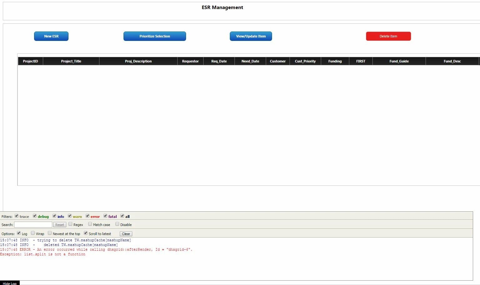

Upgraded to 7.3.4 and am receiving an odd error on all grid widgets: "Exception: list.split is not a function" Is there any information on this error and how to resolve it?
All grid widgets in existing mashups are returning this error since upgrading to 7.3.4.
Updated to reflect error message difference from Chrome and Internet Explorer
Chrome error: ERROR - An error occurred while calling dhxgrid::afterRender, Id = "dhxgrid-3". Exception: list.split is not a function
IE error: ERROR - An error occurred while calling dhxgrid::afterRender, Id = "dhxgrid-3". Exception: Object doesn't support property or method 'split'
I am looking for information on this error message and possible resolution.

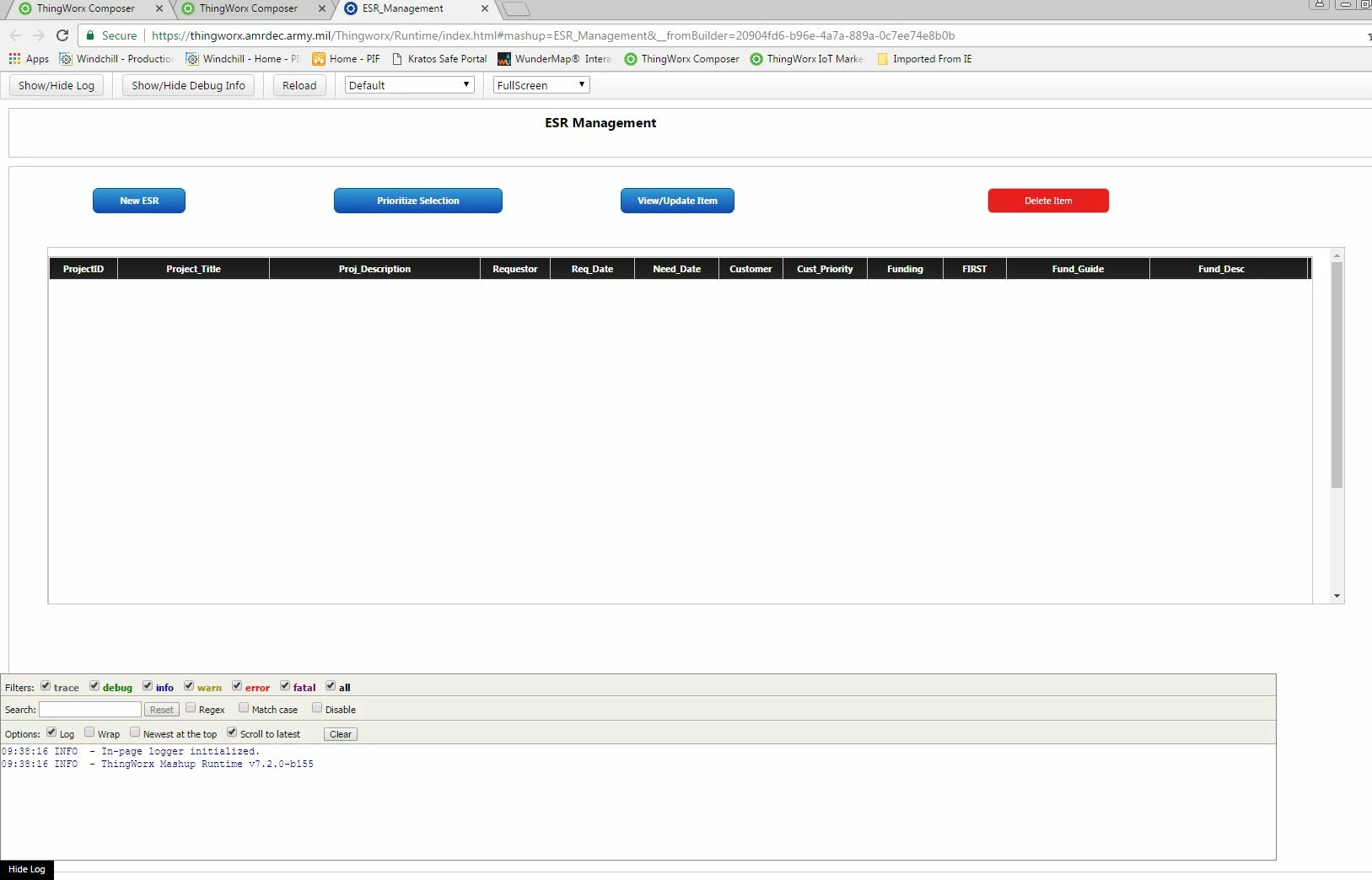

The attached mashup and associated data table and data shapes were imported to 7.2.2 and run with no errors. On 7.3.4, the mashup indicates the list.split error. Screen shots of the two environments also enclosed
