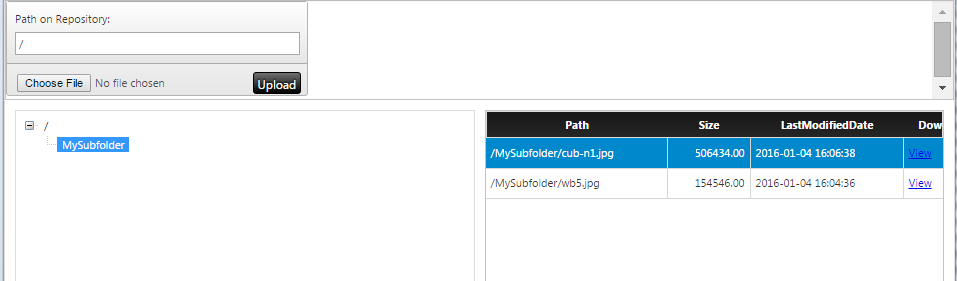

Hey, guys!
I'm working on a project lately, and I need to work on a mashup that can upload and download files(.jpg .zar .mp3).
I know that there is a widget called Upload file, but there are no download widget.
How can I download a file from the Thingworx??
Best answer by sgreywilson
Lee,
If you created upload Mashup then its just a few steps to get download to work.
Your Thing I expected used the Template of FileRepository (Which we will call MyRepo)
That things has Services you can use called GetDirectoryStructure which I expect you used. You can also use GetFileListingWithLinks. Wire the services up connecting selected rows path from the GetDirectoryStructure to Parameters of the GetFileListingWithLinks. From the UI you can use the Link in the Grid to download the file.
Note: In your File upload Mashup you would of set the RepositoryName to "MyRepo" in the FileUpload Widget which connects the Services to the UI
Hop this helps

Thanks a lot, it worked!!!
January 6, 2016
Thanks for this helpful post!  Is there anyway to download data using this method?  I tried to export data from a value stream to my repository, but it doesn't show up in the grid to download.  All other files in my repository show up.  Thanks!
January 6, 2016
I just figured it out.  You first need to use GetDirectoryStructure and feed it into a grid, then you can feed your selected row into the GetFileListingWithLinks service and in another grid your data stream or whatever you have exported will show up there and you can use the download link!  I am sure this is not a "best practice"  but if you do not have rdp access to your instance, this is a quick way to get data directly.
