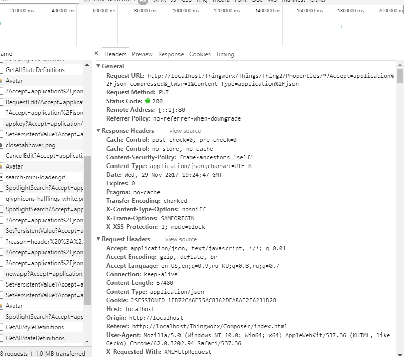

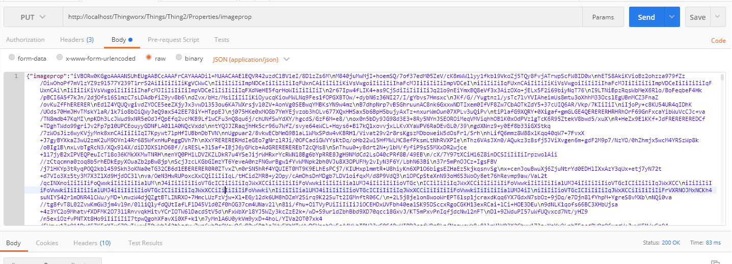

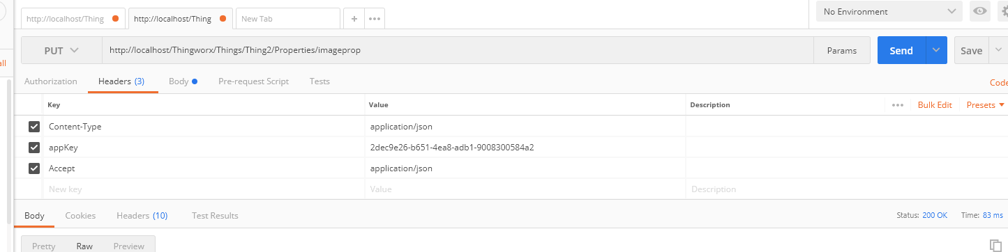

You would need the following headers: content-type, Accept, appkey.
You would send the image as application/json
For example:
The image will be in json:

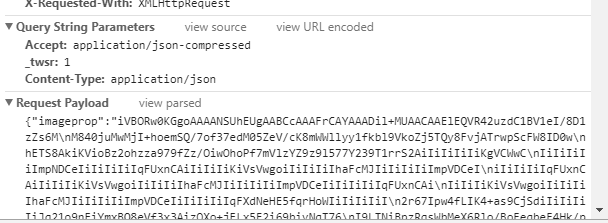

Hint: you may use your browser dev tools (Chrome - f12) to see the REST call structure when assigning an image property through the composer:
Scrolling down to the  request-payload, you can view the source:

måkerman1-VisitorAuthor
Nov 30, 2017 3:12 PM UTC
Hello Polina, and thank you!
I tried the exact way you explained and I got mixed result. The image do change in the property but I also get (500) Internal message response.
And the logging of the pimage property does not work even if the image is changed.
Do you know what it can mean?
