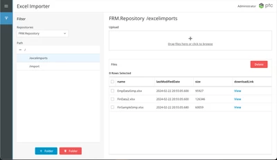

I recommend to watch the video but as a very brief abstract, the framework allows you to first browse your repository and upload files:

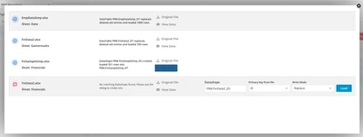

And gives you the opportunity to convert the xlsx files to Datatables afterwards.
The entry point for this framework is the "FRM.ExcelImporter_MU" Mashup.

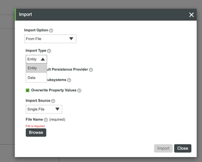

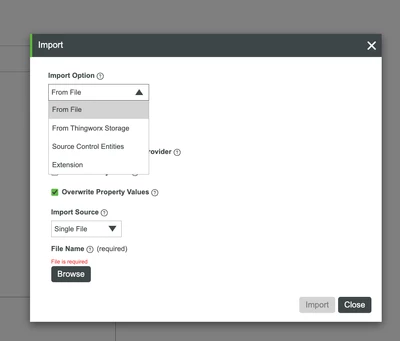

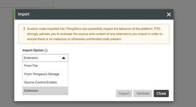

In order to use this framework you'll first have to import the excel extension and afterwards the framework entities.
Step 1: import the "excel extension.zip" as extension to ThingWorx
Step 2: extract the "FRM-Entites.twx.zip"
Step 3: Import the "FRM-Entities.twx" as Entities (From File->
Step 4: Find the FRM.ExcelImporter_MU Mashup and open it.
