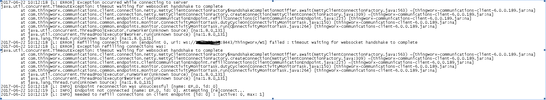

I have installed UploadThing 1.2 in Thingworx 7.4. Installation process has finished correctly but the Thing is still not connected.
Thingworx is configured in the port 8443 using SSL. I have changed the port in UploadThing.properties to 8443 but there is no improvement.
Could anyone help me?

Hi DAVID ALGUACIL​,
What are the errors in the logs? Is port 8443 open on the machine where ThingWorx is installed?

Hi Ankit Gupta​,
The port 8443 is open. When I run the command netstat -a it appears as LISTENING. Also, I am using ThingWorx through this port to work from my computer.
I don't know which logs you need. During UploadThing installation there is no errors.

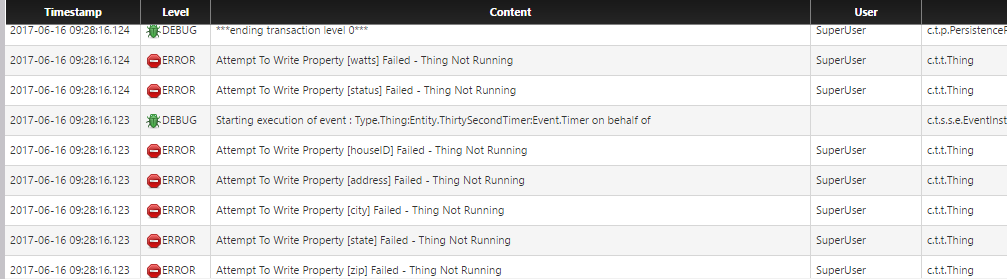

In ThingWorx Application Log, I can see the following errors that appear each 10 seconds.
Thank you very much

Since you are using SSL enabled ThingWorx so could you please verify and confirm that instance URL is as below:
wss://< IP ADDRESS> : <PORT>/Thingworx/WS
Also please advise if you get any error message on command prompt while running Install.bat file inside Upload Thing folder.

I believe you have already opened a Technical Support case ( 13736553 ) for this issue and we will provide further assistance on the same.

You are right. There is a Technical Support case created for this issue, but I have still problems with the issue.
I include the log messages for UploadThing, just in case.
