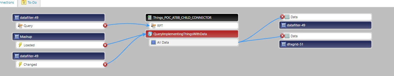

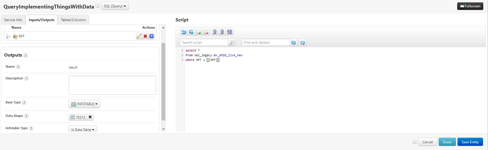

etc61-VisitorAuthor
August 28, 2019
Hey,
the provided information doesn't help a lot and the tutorial is good for the bindings but it does still not work.
1. ThingWorx 8.2.6-b456
2. When I try filtering I get this error:
org.json.JSONObject cannot be cast to java.lang.String
Here is a screen of my service and my bindings:

etc61-VisitorAuthor
September 4, 2019
I appreciate your help and I think your given solution
led me to the right direction but I still have a little problem.
I've created the new sevice and put the script inside as you said to do.
But the problem is that I don't know how I can acces the Inputparameters with the script.
I changed the names and tried various thing but I either get an NullPointerException
(08:48:15 ERROR - Error in invoking service Things_POC_ATBB_CHILD_CONNECTOR, GetPRwithoutCCR, Things, POC_ATBB_CHILD_CONNECTOR, Services, GetPRwithoutCCR. Error from the server: "Error executing service GetPRwithoutCCR. Message :: Wrapped java.lang.NullPointerException - See Script Error Log for more details.")
or my table in the mashup remains empty when I do the filtering.
I also tried to acces the properties direct but then I get this error
09:24:42 ERROR - Error in invoking service Things_POC_ATBB_CHILD_CONNECTOR, GetPRwithoutCCR, Things, POC_ATBB_CHILD_CONNECTOR, Services, GetPRwithoutCCR. Error from the server: "Error executing service GetPRwithoutCCR. Message :: TypeError: Cannot read property "RPT" from undefined - See Script Error Log for more details."
which tells me again that I have no acces to the Infotableparameter.
The filter has problems to get basic data it needs for filtering.
As I said I tried various thing (changed bindings, changed code) but I don't get this filtering done.
Any ideas?
September 4, 2019
If your initial service is returning data properly as an infotable there is no reason for this approach to not work.
I hope you have not set the new service(GetPRwithoutCCR?) to be invoked upon Mashup load(Mashup loaded checkbox). Your new service has to be triggered only after your service to fetch data from DB has completed execution. Otherwise, the infotable input would be null.
