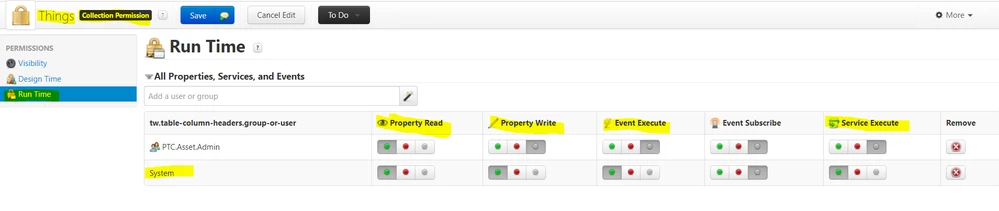

Hi @Malior.
The System user is a built-in user for executing services without having to give the logged in user explicit permissions.  Here is a screenshot showing access to the Things Collection by the System user:
Based on your scenario, you will need to provide a number of permissions to be able to perform the various functions (create, update, etc.) but there is no simple answer that would provide a solution.  You will need to rely on the log output to address each of the permissions issues as they occur.
We recommend going through the previous link that was provided for setting up the permissions and then working through each error as they occur.  After doing so, if you still have issues, a case would be the best approach for assisting you further.

Hi @Malior.
To answer your first question, yes, as a good security practice, you should create a new user that has access only to the entities required for the use case.
For the 2nd question re: the user profile settings, these only determine what is visible in Composer.  They have no effect on permissions.
For the last question, it is recommended that you wrap your services within the context of the system user which would allow the user to run the higher level service but not expose the base services for creating entities.  By doing it this way, you are controlling what is getting created vs. granting access for the creation of anything.
This previous community post may provide a better understanding of security.

Hi @Malior.
