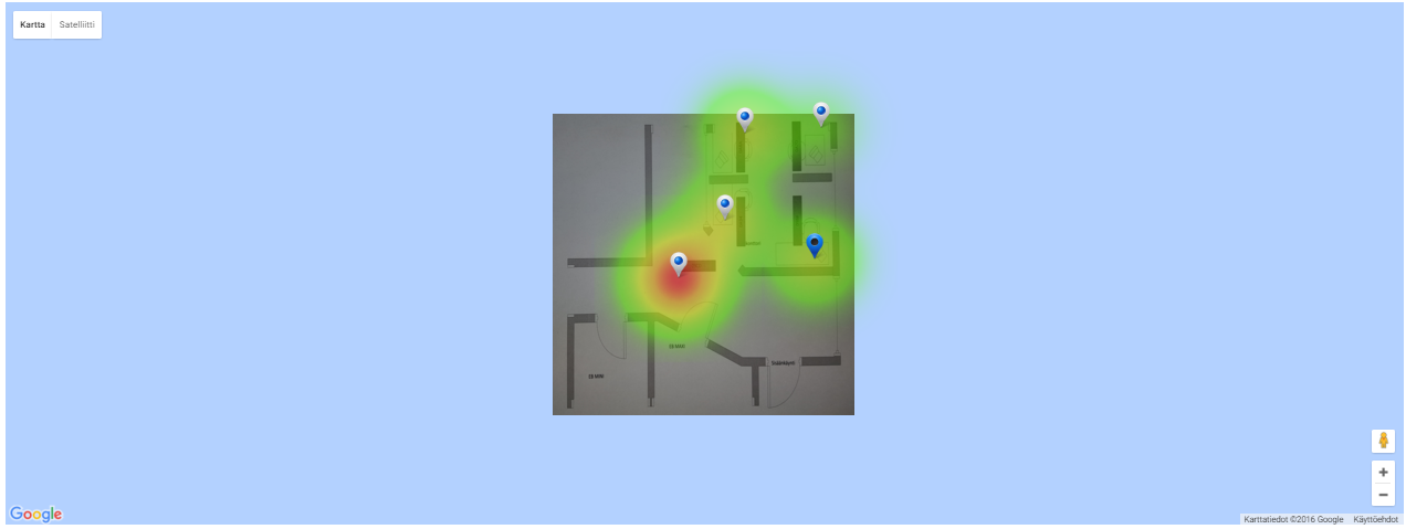

I have now taken a look on Google maps overlays (https://developers.google.com/maps/documentation/javascript/examples/groundoverlay-simple). With these it is possible to put a floor plan on top of the google map and still use all the functionality that the google maps widget already has. The results are not very pretty since the overlays always seem to be a little out of place.
The optimal solution would probably be to make a widget with the functionality of a google map but which only shows the floor plan instead of the actual map. However, I don't think we have the resources to develop that kind of widget by ourselves.
Apr 20, 2016 10:09 AM UTC
To give you some idea about what I am looking for, here is a screenshot from my current widget using google map with an overlay. The heatmap is also generated with the google maps.
