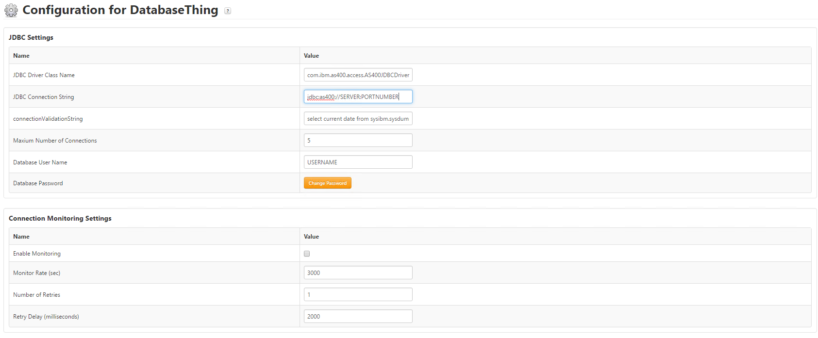

I imported the relational database extension for DB2 connectivity, but the default JDBC driver class isn't what my organization uses to connect to DB2. We use another driver class called "com.ibm.as400.access.AS400JDBCDriver".  I tried setting this in the JDBC Driver Class Name field in the DB2 Thing configuration, but I wasn't able to query a database.  I have a Jar file that we typically have to deploy to use this DB2 connection driver and I assume I have to deploy this Jar file so that ThingWorx can see it and know it exists when I try to make a connection to a DB2 database.
How do I deploy Jar file with ThingWorx/Apache so that I can use this JDBC driver?
Here are my settings (some information has been generalized):

You may build your own jdbc package/extension:
  • Download the Extension Metadata file Here
  • Download the appropriate JDBC driver
  • Build the extension structure by creating the directory lib/common
  • Place the JAR file in this directory location:
    • lib/common/<JDBC driver jar file>
  • Modify the name attribute of the ExtensionPackage entity in the metadata.xml file as needed
  • Point the file attribute of the FileResource entity to the name of the JDBC JAR file
  • The metadata also contains a ThingTemplate
  • the name is set to MySqlServer, but can be modified as needed
  • Select the lib folder and metadata.xml file and send to a zip archive
    • Tip: The name of the zip archive should match the name given in the name attribute of the ExtensionPackage entity in the metadata.xml file
  • Import the newly created extension as usual
  • To the JDBC extension, simply create a new thing and assign it the new ThingTemplate that was imported with the JDBC extension

Polina's answer was exactly correct.
Thanks Polina for the prompt reply.
