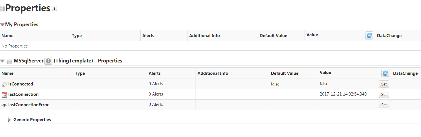

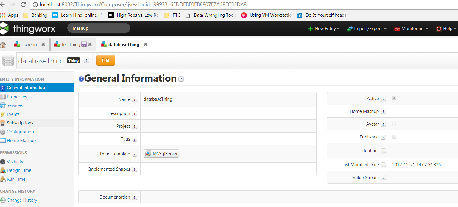

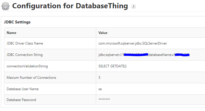

Using an mssql database. Trying to connect TWX to that but the isConnected field is false
Here is my configuration
Btw, I'm using windows authentication for my database

Hi Arvind,
Follow below mentioned steps, you can able to connect MSSQL DB:
1. Import Relational DB Connectors from ThingWorx IoT Marketplace
2. Create a Thing With "Database" Thing Template.
3. Then navigate to "Configuration" and Fill required details.
  • JDBC Driver Class Name : com.microsoft.sqlserver.jdbc.SQLServerDriver
  • JDBC Connection String : jdbc:sqlserver://hostip:port;databaseName=DBName
  • connectionValidationString : SELECT GETDATE()
  • Provide DB user name and Password.
*It will work with DB password.
That's all!!!
Thanks.
Sathishkumar C.

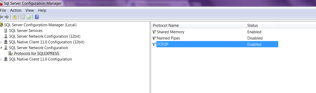

Arvind, you'll need to have the TCP/IP enabled for the client protocol and need to restart the SQL Server service. All of this should be doable within the UI have you have shared from the SQL Server Configuration Manager. You can first test with the SQL Server Authentication if that is working and if you'd like to have Windows Authentication only option then in that case you'll need the Integrated security enabled in the JDBC connection string e.g.  Integrated Security=true

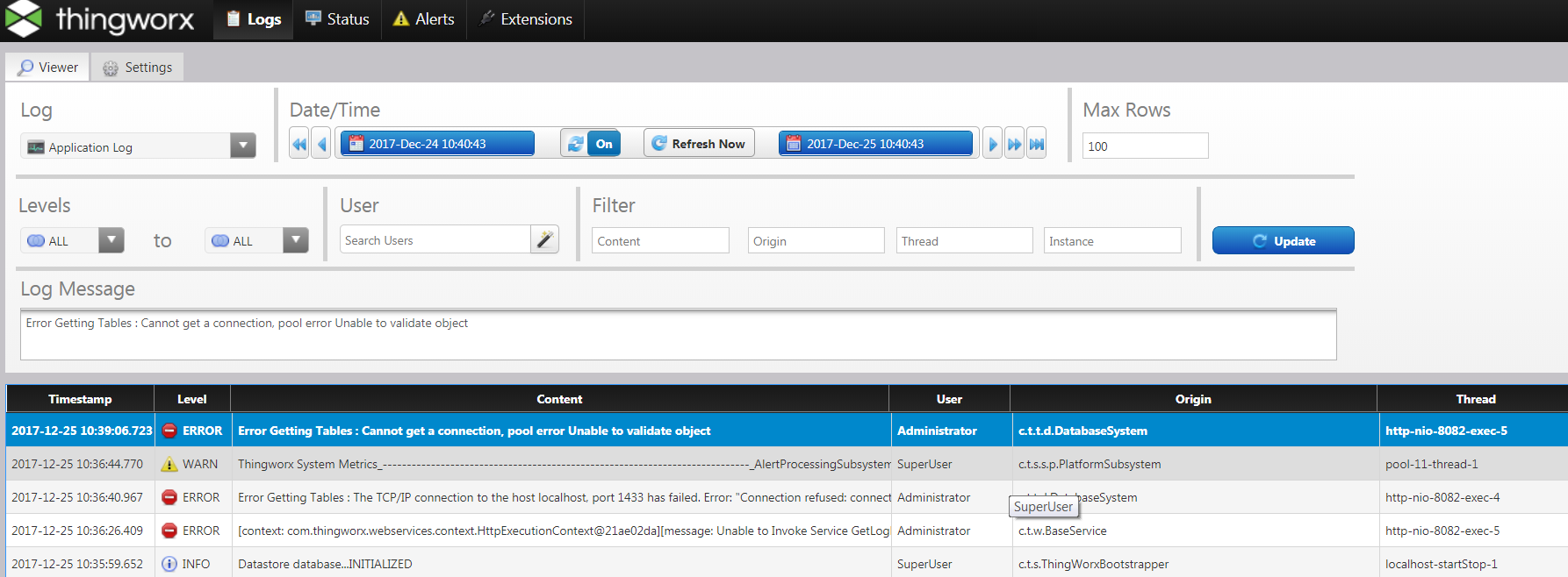

Latest log

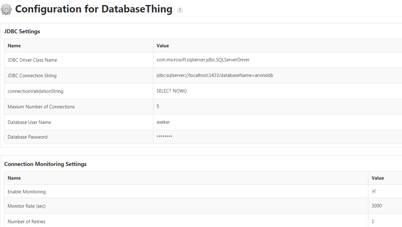

I tried changing the below
December 25, 2017

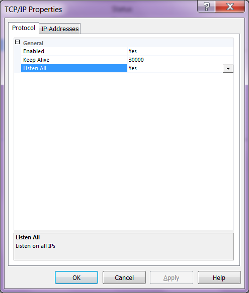

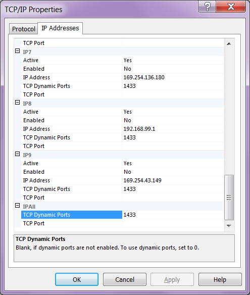

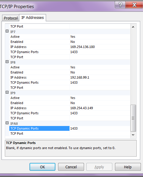

The 3rd log in the Application log shows that there's still some issue in establishing connection, as you can see in the error the connection is being rejected by the Database. Can you please share the screenshot of the SQL Configuration Utility where you have enabled the TPC/IP ?
Even though your setup appears to be same machine i.e. database and the ThingWorx server, could you please ensure that no firewall/antivirus software is blocking this connection?

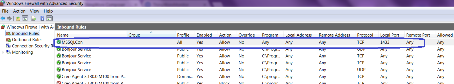

The issue got resolved last week. Just got time to update this thread.
TCP/IP to be enabled
Firewall for SQL port to be created
Re-create the database thing in Thingworx. The changes doesn't seem to affect the existing database thing.
