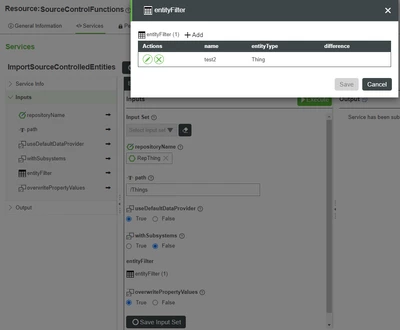

How can i use the ImportSourceControlledEntities  service to import a single entity: I guess i need to use the entityFilter parameter, but i'm not able to find the correct syntax:
   let entityFilter = Resources["InfoTableFunctions"].CreateInfoTableFromDataShape({
        infoTableName: "InfoTable",
        dataShapeName: "EntityDifference"
    entityFilter.AddRow({name: "myTemplateToImport", entityType:"ThingTemplate"});
    Resources["SourceControlFunctions"].ImportSourceControlledEntities({
         entityFilter: entityFilter,
         repositoryName: "SystemRepository",
         path: "src/twx-source"
Any help or example would be appreciate.

August 4, 2022
I attached a picture where I ran ImportSourceControlledEntities from composer. I defined entityFilter to only import thing with name "test2".
For your use case, you can define InfoTable with data shaple "EntityDifference", add a row to with entityType as "Thing" and name as target thing name.
