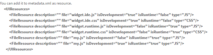

    Hello, I found another thread in community talking about "How can I reference my js libraries in custom extension widget", that introduced custom js file into widgets, so that might also give you ideas in how to import your 3rd party library.
    Here's the link for the thread https://community.thingworx.com/thread/39606?&posno=20&q=import%20library&ProductFamily=ThingWorx&source=search
