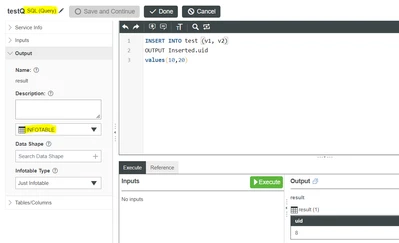

Best answer by Sathishkumar_C
Use service type as "Query" as following,

January 3, 2023

I was under the assumption that insert/update/delete only worked using the "command" type of SQL on TWX.
This is exactly what I was looking for!
