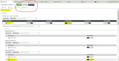

While editing PlatformSubsystem permissions, iam not able to save the changes.
